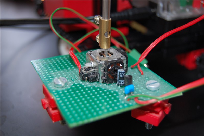

Yes and no. This camera module on the robot is really new.
But I made the joystick for an earlier robot, with omniwheels. You can find it here: Omniwheels I just reused the joystick.

Hallo, Mich würden nähere Infos über den Joystick interessieren, kann man den an das Robo Interface anschließen, was ist das genau für ein Joystick ? Was sind das noch für zusätzliche E-Bauteile ?
Gruß Frederik

The joystick is a standard part from Conrad. The extra parts are a 5 Volt regulator and some capacitors. So, the joystick is just used as a voltage divider, and is connected directly to the A1 and A2 analogue inputs. Since I use 5 V, the input range will be roughly 0..500.
