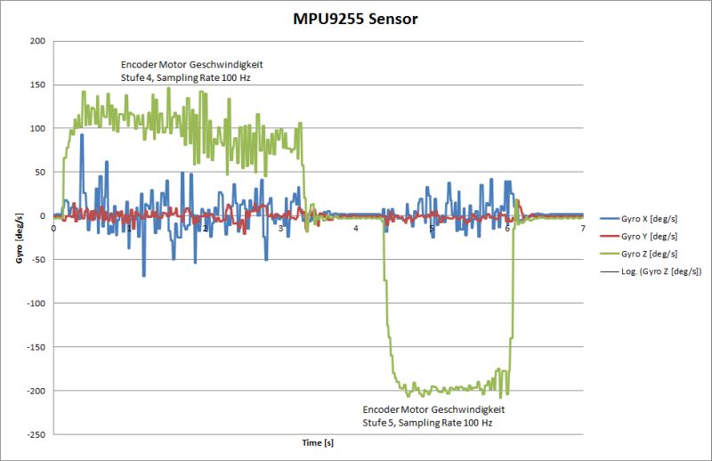

MPU9255 Gyroscope data
Konstruiert und fotografiert von chehr.
Hochgeladen am 13.2.2016, 21:30 von chehr.  10 / 10
Schlagworte: MPU6050, MPU9150, MPU9250, Gyroscope, Speed, control, Sensor.
Objective: I2C MPU driver optimization wrt user needs. Setup: Encodermotor with Turning table and lever arm. The Sensor MPU9255 is located at the outer position with a lever arm of approx. 17cm. Table is rotated firstly by +360° afterwards by -360° with two different speed. No closed loop control. MPU9255 Gyroscope Sensor data has been recorded. Issues: “Closed loop Speed control “ is missing in RoboPro Accurate sampling rat
