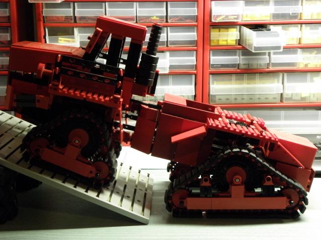

helling
Konstruiert von ruurd. Fotografiert von chef8.
Hochgeladen am 3.5.2010, 11:26 von chef8.  11 / 12
Geen probleem deze helling, power genoeg dankzij de 2 motoren
Stefan Falk (3.5.2010, 19:53:32)
Well done! Does this vehicle have two motors in reality? Interesting.
Regards, Stefan
chef8 (3.5.2010, 21:46:33)
yes it has 2 motors one in the front and one in the rear connect through a diff. Because of the different in de speed of the motors. That diff is directly connected to the central diff. And the central diff is connected to the front and rear axel. The lower propshaft is directly from the front motor. The upper one is connected to the front axel diff
Groeten Ruurd
