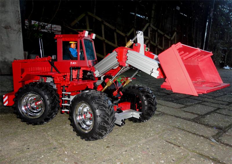

Caterpillar-950H-2.0 mit Dreh-Zylinder und -Antrieb Info
Hochgeladen am 24.1.2015, 21:42 von peterholland.  16 / 16
Schaal 1 : 14
Dreh-Zylinder Antrieb Alternativen Schau mal : http://www.ftcommunity.de/details.php?image_id=39290
Conrad-art.nrs: 297313 Messing buis buitenØ5,0 binnenØ4,1 mm, 500mm 221795 Messing buis buitenØ6,0 binnenØ4,0 mm, 500mm 297321-62 Messing-Rohr-Profil 6 mm buiten + 5.1 mm binnen , 500 mm 225410 Stelringset 4mm (10 stuks) 225428 Stelringset 5mm (10 stuks) 225436 Stelringset 6mm (10 stuks) 295612 KOGELLAGER inw. 6mm x 12 x 4 RVS-Draadeinden : https://www.rvspaleis.nl/ 221786 Draadeind 500mm M4 Messing 221787 Draadeind 500mm M5 Messing 183745 Mentor Askoppelingen 720.64 (Ø) 6 mm naar 4 mm Adapter 4mm auf 5mm Andreas Tacke Münster. Ich mache davon M4 auf 5mm.
Interessante sehr kleine (10 x 12 x26mm) Getriebemotoren passend im FT-Raster gibt es bei :
https://iprototype.nl/products/robotics/servo-motors/micro-metalen-gearmotor-hp-100:1
http://www.pololu.com/product/2218
Overview
These tiny brushed DC gearmotors are intended for use at 6 V, though in general, these kinds of motors can run at voltages above and below this nominal voltage, so they should comfortably operate in the 3 - 9 V range (rotation can start at voltages as low as 0.5 V). Lower voltages might not be practical, and higher voltages could start negatively affecting the life of the motor. The micro metal gearmotors are available in a wide range of gear ratios-from 5:1 up to 1000:1-and offer a choice between three different motors: high-power (HP), medium-power (MP), and standard. With the exception of the 1000:1 gear ratio versions, all of the micro metal gearmotors have the same physical dimensions, so one version can be easily swapped for another if your design requirements change.
Ook interessant in 12V -uitvoering (levering vanuit Frankrijk) : http://www.robotshop.com/eu/en/12v-460rpm-20oz-in-micro-gearmotor.html
12 6 - 12 5:1 4900 RB-Sct-805 Servo City 12 6 - 12 10:1 2600 RB-Sct-553 Servo City 12 6 - 12 30:1 900 RB-Sct-749 Servo City 12 6 - 12 50:1 460 RB-Sct-773 Servo City 12 6 - 12 100:1 270 RB-Sct-722 Servo City 12 6 - 12 150:1 175 RB-Sct-171 Servo City 12 6 - 12 210:1 130 RB-Sct-810 Servo City 12 6 - 12 250:1 110 RB-Sct-697 Servo City 12 6 - 12 298:1 90 RB-Sct-169 Servo City
Stefan Falk (25.1.2015, 14:41:30)
Der sieht ja vollständig Baustellen-tauglich aus, super! Nur die Räder sind dafür viel zu sauber und glänzend ;-)
Gruß, Stefan
JaSpiel (25.1.2015, 14:51:32)
(voor de zoveelste keer) Indrukwekkend Peter. Niet alleen het model, ook de documentatie.
Inderdaad Stefan, de banden zijn te mooi. Maar schone handen, zonder olie of vet, lijken me gewenst: hoe professioneel en realiteitsgetrouw FT met enige hulpmiddelen ook wordt, het blijft speelgoed.
Groet, Jack
