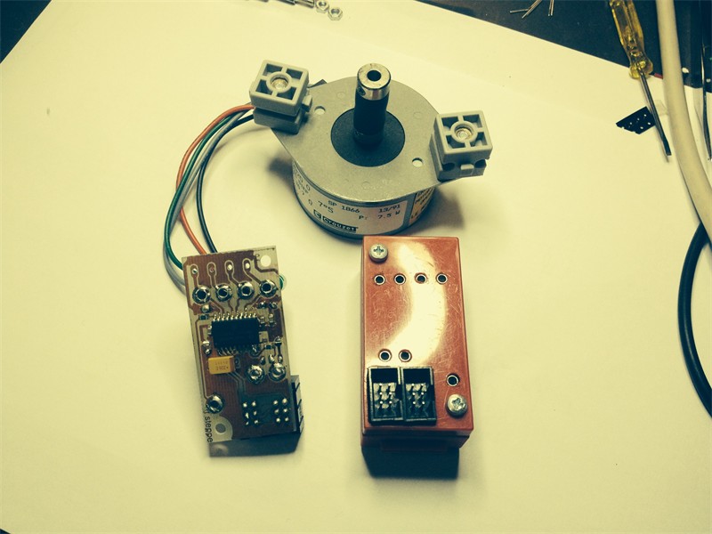

Stepper motor controller bottom view
Konstruiert und fotografiert von Ad.
Hochgeladen am 3.3.2014, 11:03 von Ad.  5 / 5
Very few components are required. 32 units can be controlled over a single I2C bus. my TX-bridge however only supports 4. It does however support advanced motor control in the sense that the motor speeds can be linked to each other. When setting different number of steps for two motors and designating one as master for the other, the motors will reach their destinations simultaneously. This is accomplished with the Bresenham algorithm which makes this ideal for plotters.

Ad (6.3.2014, 16:59:11)
The print you see in the picture was home-made (single sided) but designed with Eagle and hence could also be ordered from OSHPark for the same price as the tx-bridge because you pay per square inch ($5/in2). If I would order there I would however redesign it as a double sided PCB for wider traces and better cooling. It costs the same. Of this PCB you would need one per stepper motor so you could probably fill an order of three for your own. I will post this design as well and when I have time, redesign the PCB. The chips I ordered directly from ONSEMI (I think 5 for $25 or so). The alternative (without stall detection) TMC222 costs about ¤10 at Reichelt.
Ad (6.3.2014, 17:03:20)
By the way, the Bresenham algorithm resides in the tx-bridge not in the motor controller.
