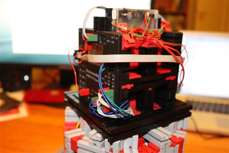

The controllers (1)
Hochgeladen am 18.1.2014, 17:48 von winijenh.  15 / 20
The brains are on top of the frame. Two TX controllers (needed for the 6 counters), and between it (from bottom to top) the gyro/accelerometer/magnometer board, the decoder printer, the battery, and the remote control unit.
