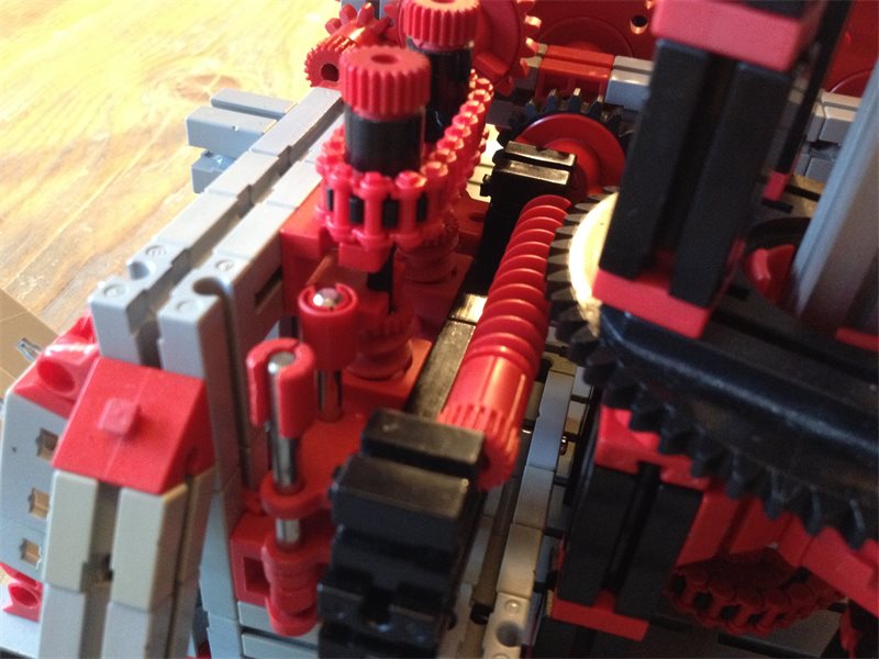

Sun Orbit connect / deconnect 2
Konstruiert und fotografiert von Richard van Wijk.
Hochgeladen am 10.1.2016, 17:44 von rvwijk.  8 / 10
Detail of the mechanism to connect and deconnect the rotation around the sun from / to the motor. In this detail it is deconnected (wormwheel down). The whole system can now be turned manually / by hand
