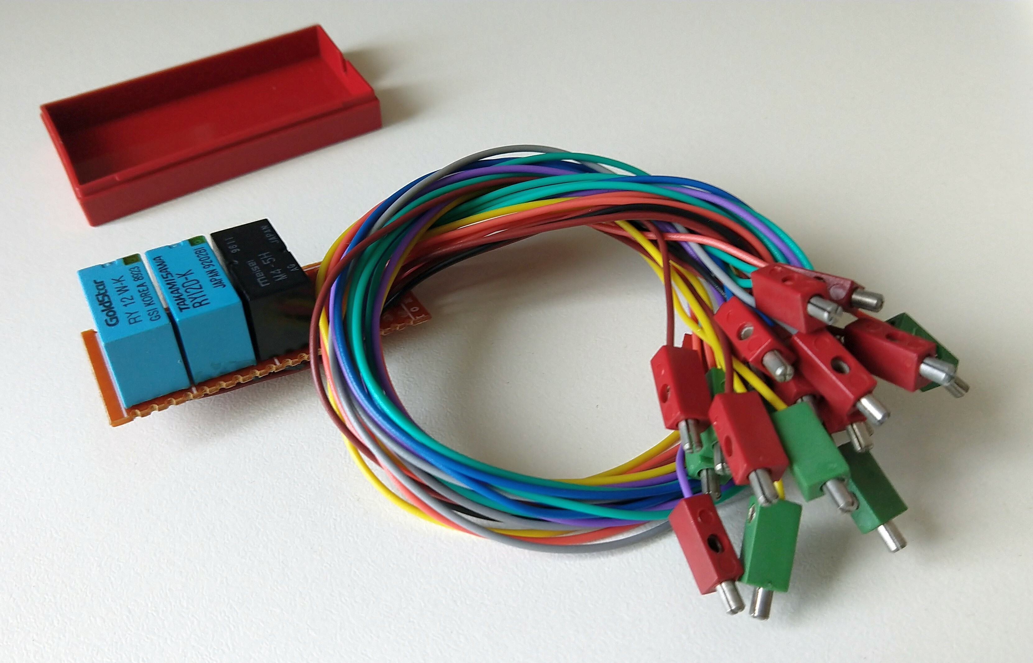

Relay module
Konstruiert und fotografiert von Rubem Pechansky.
Hochgeladen am 16.3.2021, 19:00 von Website-Team.  5 / 16
One of main challenges was to find a way to drive five reversible motors and two lamps from the TXT, which has very few outputs. This was circumvented by the custom-made relay assembly shown in the photo. It has three 12-volt DPDT (double pole double throw) relays taken from scrap material and soldered to a PCB which in turn is mounted on a fischertechnik 60 x 120 9-volt battery case lid. Two relays allow the gate motors to use the same outputs as the elevator motors, because they don’t all operate at the same time. A third relay allows the barge motor to run. A better idea would be to create an I2C module with an Arduino and some motor drivers, but the relays were simple and effective.
